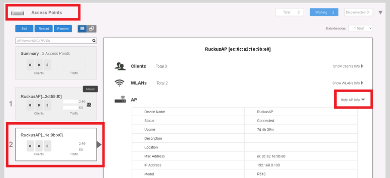

II) Please share the Screenshots from the Unleashed dashboard as shown in the below picture:
Once you are logged in to the ICX-7150-C12P console please follow up the same steps that are on point '2' using the same commands and share the output of each command.

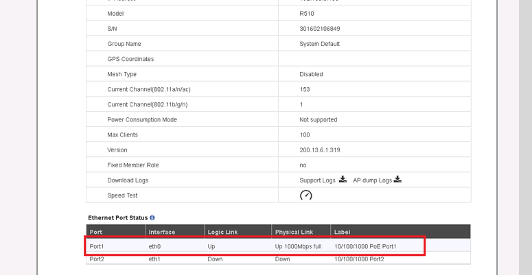

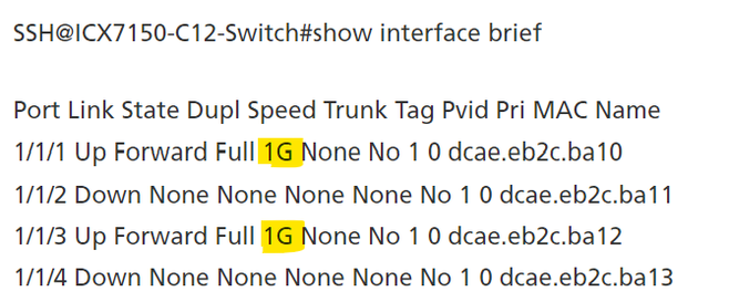

As we can see the Ports are "operating" to transmit a speed of 1Gbps which is the correct speed (Please refer to the below screenshot). Which states that there are no Hardware issues between the ICX-7150-C12P Switch and Access Points.
We suggest you confirm the speed transmitted by your Internet Service Provider (ISP). You could check the ISP connectivity from the Router, maybe with Local Router Wi-Fi or by an Ethernet cable from the Router a laptop, or a PC (Please refer to the below screenshot).
Could you please let me know the model of the Access Point you are using?
