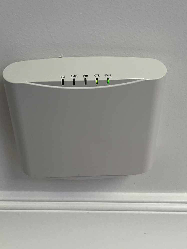

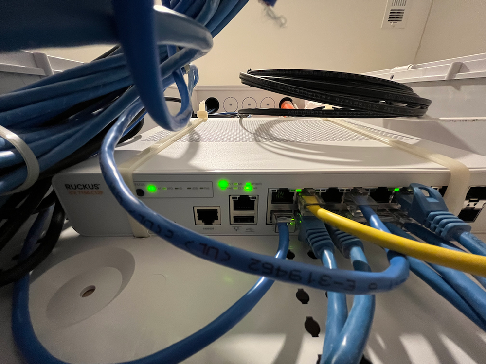

07-17-2023 11:32 AM - edited 07-17-2023 11:36 AM
Thanks again Jayavidhya
In the ICX, lights 2, 6 and 7 are all ON (green). Lights 10 are green and blink every 5 to 6 seconds all at the same time.
I have 3 access points. In one access point, CTRL is solid green, and PWR is blinking green (System started, no routable IP address detected).
In the other two, the PWR and CTRL LEDs are blinking green in a slow pattern (Network problem. Cannot contact Unleashed Master).
In the ICX picture, it looks as if the UPDATE LED is on, but it isn't.
In the AP picture, I got it when both lights were on, but as mentioned above, they're blinking.
