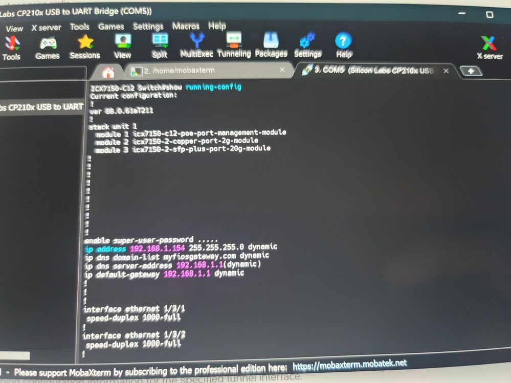

I power reset my ICX 7150 yesterday and since I've been trying to figure out, by using post from this forum, if my switch is working properly or not. After the power reset I've attempted to tftp into the switch to verify the configuration and/or it's settings to no avail. Does anyone have a procedure I can use to console or tftp into the switch to determine if it's operational or not? Is there a YouTube video that details the right steps to take with this switch? Where would I go to find the correct settings for a ICX7150? In this day and age I find it crazy that this information isn't at an easily located site somewhere, like this forum.

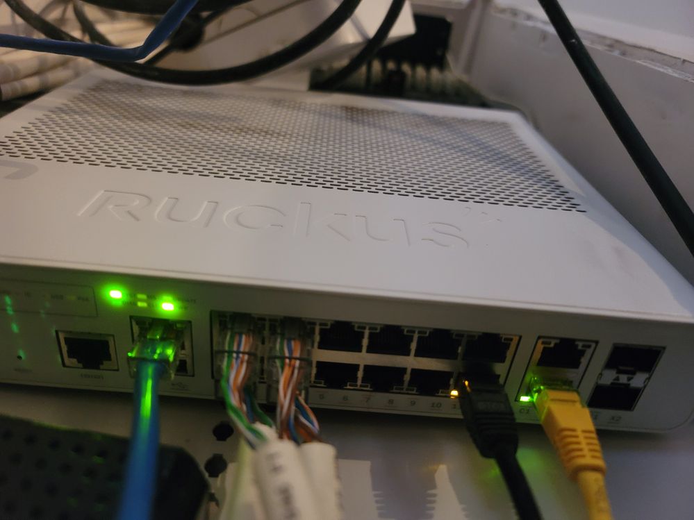

For detailed understanding of the issue please let us know the LED status of the switch and the access points using the below guide.
R510 LED lights
RUCKUS LED lights
Also please share the image of the switch and the access points showing the LED status and the cable connections.
Jaya,
All R510 LED lights are out/extinguished and the ICX 7150 Syst & Pwr = Green, C1 = green, port1-4 = out/extinguished, port 12 amber
Valued Contributor III
Hi @Jemalsimmons
Based on the images, you have shared it seems like the cables coming from the router/ access points are wrongly connected to the switch.
Please make sure the cable is actually connected to the ICX-7150-C12P ( Switch ) in one of the 12 ports in the middle of the switch
