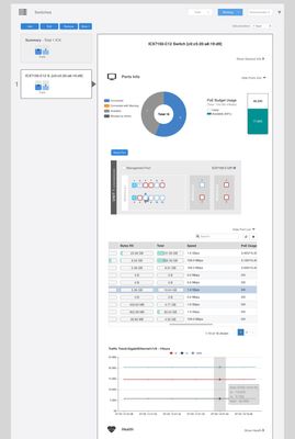

Before I assist you further, could you please log in to your Unleashed system on a LAPTOP WEB BROWSER using the Master AP IP Address OR https://unleashed.ruckuswireless.com/ and share a screenshot showing the information below highlighted in the screenshot?

To proceed with further assistance on this issue, could you please refer to the attached image and share a comprehensive picture showing all cable connections to the switch ports?
