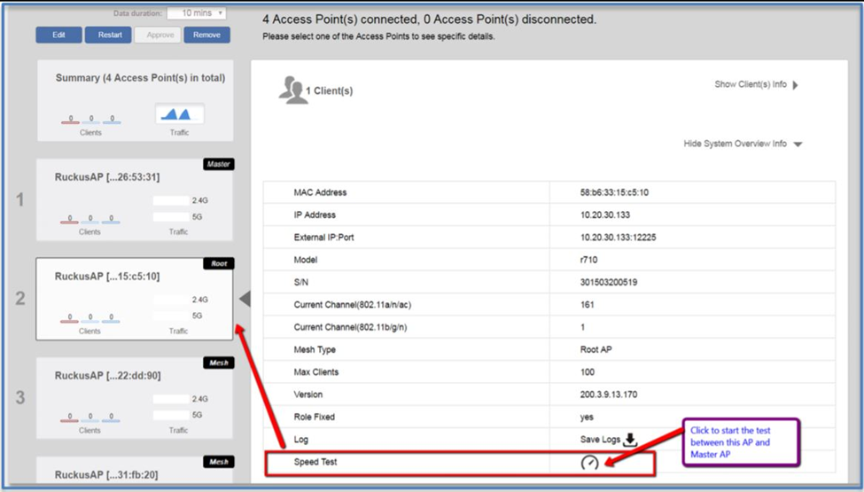

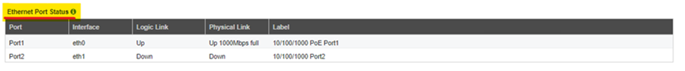

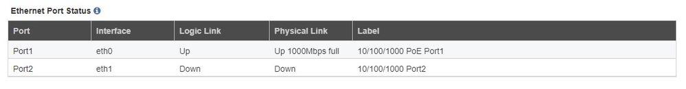

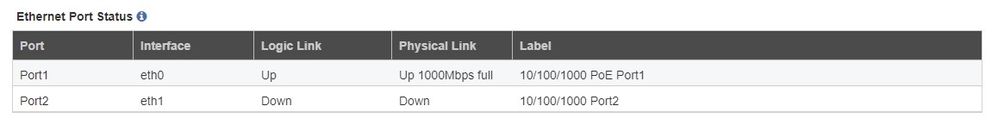

2. Take separate screenshots for each Access Point, similar to the example provided below to check the AP port speed.

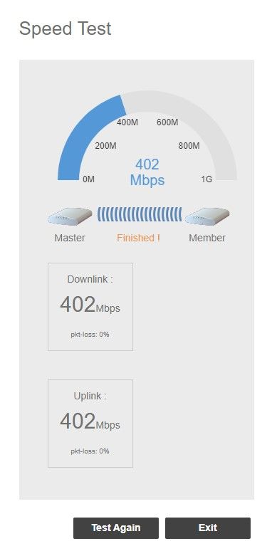

3. Additionally, perform a SpeedFlex test to measure the speeds between the Master and Member Access Points. Refer to the screenshot below for the SpeedFlex process.
Please provide the requested screenshots and test results at your earliest convenience.
Thank you again for your patience and cooperation.

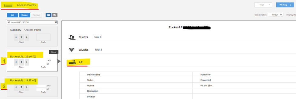

asaad1972
Hi Imran,
Here are the screenshots.
Thanks
Ashraf
Hi @asaad1972
Thank you for your response and the information you provided.
Based on the screenshot output, everything appears to be normal. To further troubleshoot, please create a new WLAN/SSID and try. We suggest configure a separate 5GHz and 2.4G radio network on your Unleashed Access Point to minimize any potential wireless interference with the each radios.
