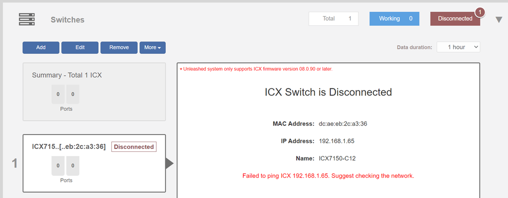

I've tried upgrading the firmware and it was unsuccessful. The only error within the dashboard is "*Unleashed system only supports ICX firmware version 08.0.90 or later."
I can access the dashboard through this address https://192.168.1.67/admin/dashboard.jsp?privilege=rw
The switch had an IP of 192.168.1.65 then I modified it to 192.167.1.67 and now it just says "ICX Switch is Connecting" and won't proceed to connect. Before I modified it, it said "Disconnected".
I can connect to my WiFi but the internet is really slow and in most cases it times out.

Also, please share the image of the status of the switch in the unleashed app as mentioned below.

Hello @DLT ,
From the response you shared, I see that the Switch is in a lower version.
This may happen when your RUCKUS Switch is on an older version which doesn’t let you log into the Unleashed application. We suggest you upgrade your Switch to the recommended version(8095g) to avoid this issue in the future.
Before we can help, we need to check which version the Switch is currently running.
1. To check this, we must identify the ‘current’ IP address assigned by your local router to the switch ICX-7150-C12P
ICX7150-C12 Router> OR
ICX7150-C12 Switch>
show version
show flash
