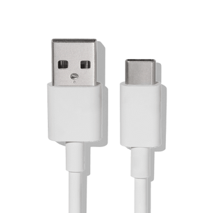

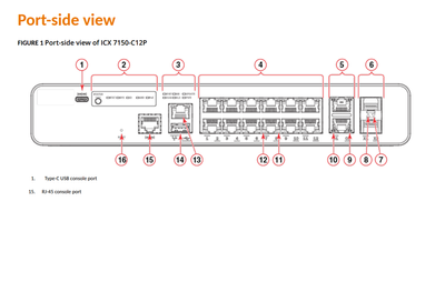

You will need one of the following cables:
Or

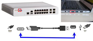

2-You will need to connect the console cable into the console port (Number 1 or 15 depending on your cable) and connect to a USB on your workstation (Computer).

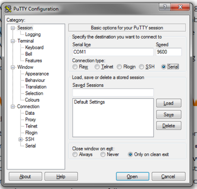

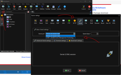

5-Open a session in putty or MobaXterm with the following settings:
This is a putty session:

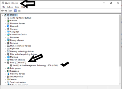

NOTE: The “Serial line” will change from “COM1” to “COMx”, it depends on how many connections your computer currently has. To identify the one, we need go to “Device manager” and locale the USB console connection. In the following example is letting us that the USB is on COM3
The MobaXterm app will recognize automatically the USB connection.

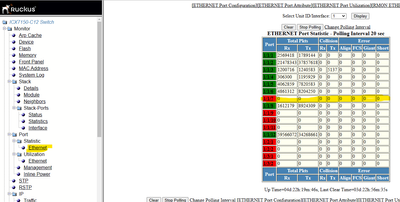

Just wanted to let you know that, while the suggestions did not solve my problem, they did provide enough information for me to constantly monitor the issue. I conclude that I have 1 port on the switch that was creating all my havoc (port 7). By using the web interface:
I was able to monitor and I saw that if I attempted to use port 7, all my devices would suffer drops. Is there anything further that I can do to look at that port in particular?
