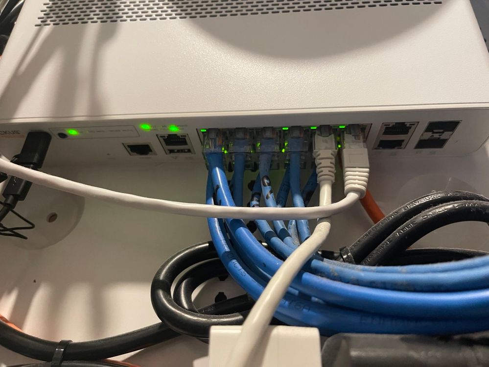

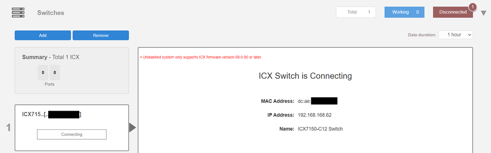

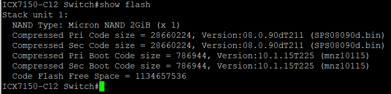

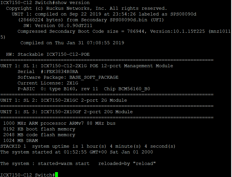

I went through the steps to resolve and I'm getting an IP address now, which is great, but now it's stuck on this Connecting (discovery) state.  Further research through other subjects either weren't helpful or I didn't feel comfortable flashing unknown versions or changing configurations.  Here are some diagnostic images for analysis:
RuckusSwitchCabling.jpegRuckusSwitchShowVersion.pngRuckusSwitchShowFlash.jpeg.pngRuckusSwitchShowWho.png

Hello @trinakas ,
Thank you for the information you shared and the screenshots.
From the case description, I understand that the version on the Switch is 08.0.90d.
We recommend transitioning to version 08.0.95g, identified as the stable version for Lennar Home users.
To facilitate this transition, we have recently introduced an upgrade tool tailored to ensure a seamless process. Utilizing this tool is straightforward: users simply need to input the IP Address, Username, and password associated with the Switch into the software interface.
For your convenience, please find the necessary resources below:
  1. Download the Upgrade software for Windows: Link: Upgrade Software for Windows
  2. Access the Upgrade Software User Manual: Link: Upgrade Tool User Guide for Lennar SmartHome users
Once the upgrade is completed, the Switch will reboot and it will connect to the Unleashed
Please note: For now the tool works only on 08080f and versions between 08095g.
We highly value your input and would greatly appreciate your feedback on our upgrade tool. Your insights are instrumental in our ongoing efforts to enhance user experience and ensure the tool meets your needs effectively. Please take a moment to share your thoughts, suggestions, or any issues you encountered while using the tool. Your feedback is invaluable to us and will guide us in further improving the tool for all our users. Thank you for your time and contribution.
Should you require any assistance throughout the process, please do not hesitate to reach out. Your satisfaction is our priority, and we are here to support you every step of the way.

trinakas
Hi Pinky,
I was able to download the app, run it, connect to the switch, perform the upgrade and after about 20 mins it looked like everything came back online, but the upgrade software didn't reconnect.  It just hung with the dialog open saying not to close it.  I had my putty session open the whole time connected by the serial port and was able to observe the whole process which was kind of neat.  I didn't see any further action there so I closed the dialog anyway, ran it again, it connected again, and went to 100% green saying successful.  I see the latest version of 08.0.95g is installed.  I reopened the Ruckus iOS app and the status for the switch looks good (Connected) now.
I really appreciate the help!
