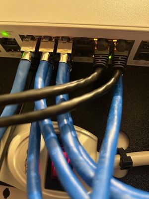

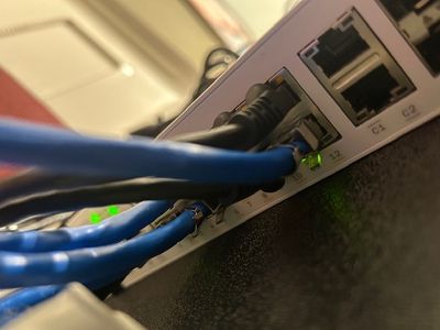

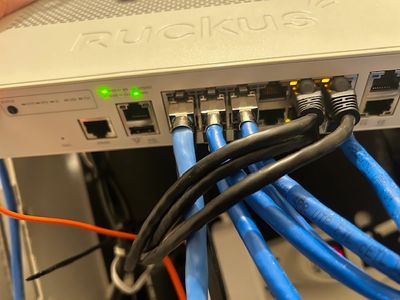

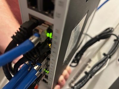

2. Please check the status of the lights on your switch while it's connected to the outlet. Specifically, look for amber or green lights and let us know which lights are illuminated. Could you provide a photo of the switch panel displaying the light status and the complete cable connections to the switch ports?
3. How many Access Points are currently connected to the switch? We would appreciate it if you could describe the light status on the Access Points. If any lights are illuminated, please refer to the provided picture and share an image showcasing the status of the Access Points.
Kindly assist us by providing pictures of your ICX-7150-C12P Switch illustrating the status of the lights and the cable connections to the switch ports, as well as the light status of the Access Points.

2. There are green and amber lights.

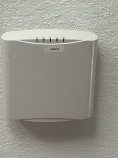

3. there are 2 WAP's connected to this Ruckus switch. Both access point lights are completely blank (no green or amber).
one example below:
