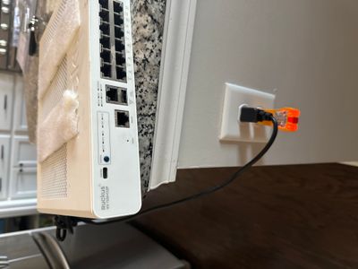

The icx7150- panel is not working. Will not give power to the indoor AP. I try to reset and still not working. There is no green lights on the panel. Only a blue light flashing on the bottom of the panel. I reset the panel unplugged and still no lights on.

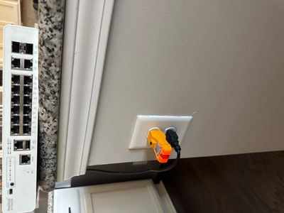

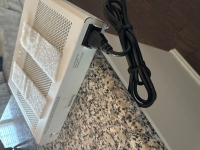

Please remove the ICX-7150-C12P Switch from the cabin and plug your Switch into a working power outlet and send us PICTURES and VIDEO of it showing the light status, and cord connected to the Switch and a working power outlet. Please refer to the below pictures as an example.

Hi @PaulP
Thank you for sharing the requested PICTURES and a VIDEO.
Based on the troubleshooting done, your ICX-7150-C12P Switch is not powering up, and when plugged in, it flashes an amber light and then goes dark. And you confirm that the Switch is plugged into a well-known outlet/power source. However, the failure persists. This Switch unit Should be RMA (Return Merchandise Authorization) in simple words replacing it.
