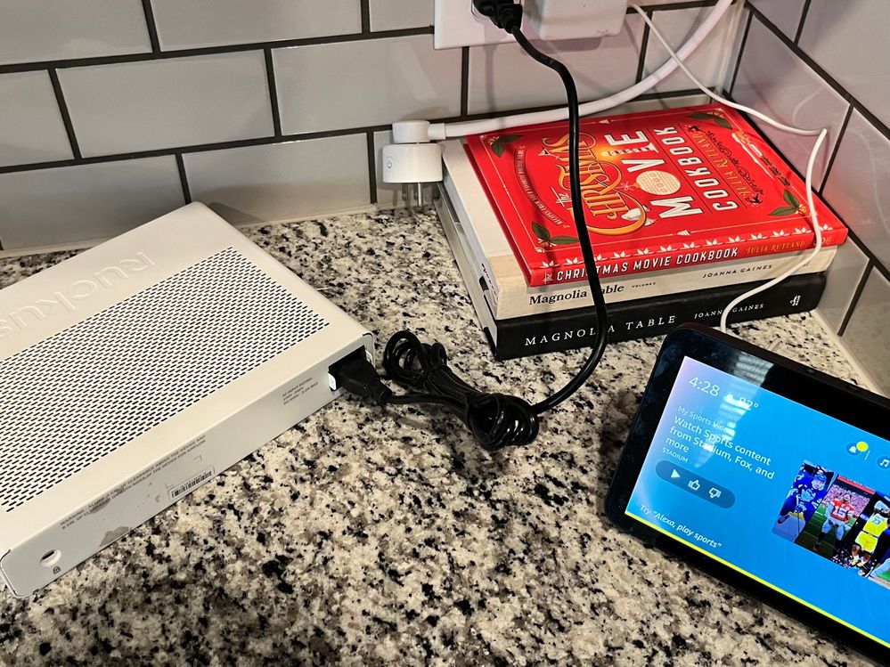

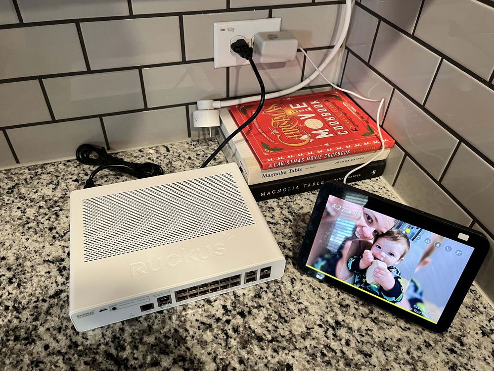

Thank you very much for the patients Now that I'm home and have had a moment to focus on this here are two photos of the switch plugged in and I've uploaded a video of plugging the switch into a working outlet to the google drive link provided. The file is labled IMG_0234.mov

Hi @Miketallica
Greetings of the day!!!
Thank you for sharing the requested PICTURES and a VIDEO.
Based on the troubleshooting done, your ICX-7150-C12P Switch is not powering up, and when plugged in, it flashes an amber light and then goes dark. You confirm that the Switch is plugged into a well-known outlet/power source. However, the failure persists. This Switch unit Should be RMA (Return Merchandise Authorization) in simple words replacing it.
Feel free to contact us via chat. When asked/prompted on chat, share the Serial Number of the Switch and the link of this post (URL), and paste it into the chat to start the unit replacement.
