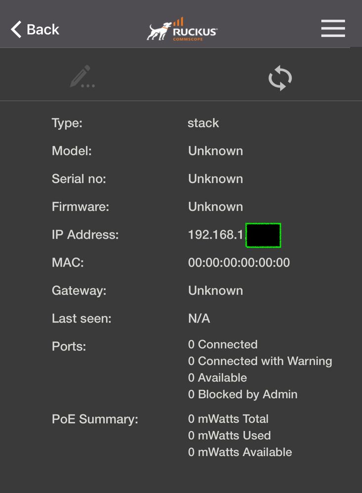

After doing a software recovery using the guided links and videos on youtube.
On my unleash app. Port switch still shows discovery... been 1hr.. what are the next steps???
System Light and Pwr is green. 3 of my AP R510 working but only on 2.4ghz

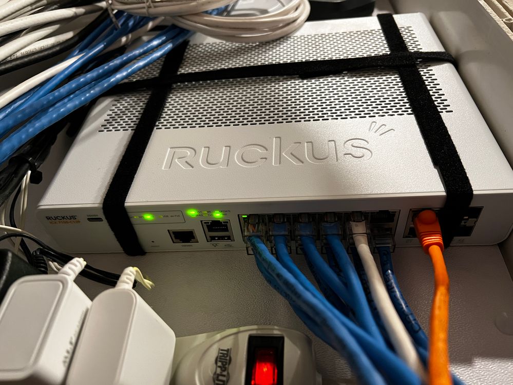

2. Please refer to the below picture and share a picture of the same, showing the FULL Switch panel cable connections to the Switch ports.
Please let me know the answers to ALL the above queries or let me know if you have any queries in this regard.

Thanks for your prompt response... This was installed 4yrs ago by Lennar. Had issues before but was able to get assistance maybe 4-5x in the past 4yrs.. No power outage.
Just tried to restart and reset then the whole system wouldn't bootup until i did the software recovery on the console using the guided steps through tftp and putty.
Now. it booted up. my AP R510's workinng, but the switch still not showing firmware and SN, and Mac Address. cant even get through the https://unleashed.ruckuswireless.com/admin/login.jsp

Hi @jedy52
As I see from the picture you shared, seems like the ethernet cable which is coming from the ISP’s (Internet Service Provider’s) Router or Modem/Router combo is plugged into the wrong port on the Switch panel. It must be plugged into any 1 in-12 ports as shown in the below screenshot. Please unplug the ethernet cable and plug it into the correct port and try again. If required reboot (unplug and plug from the power outlet) the ISP Router and the RUCKUS ICX-7150-C12P Switch once.
