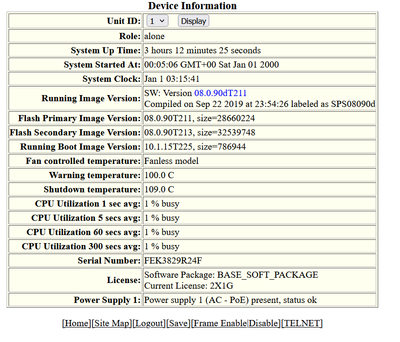

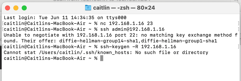

Trying to get the terminal on mac to work was my issue to begin with and seemed to not show what the cases showed. Anyways I logged into the switch dashboard. Is this the version info you are looking for?
Here is what I get from terminal options
