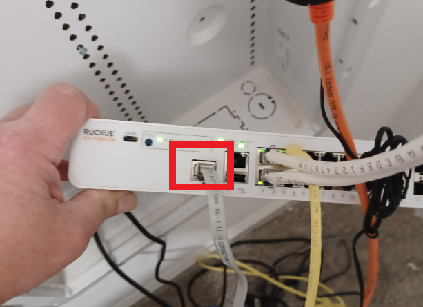

I can log into the switch via laptop on wireless. Unplugged the APs from the switch and reconnected. I was able to refresh the page for the switch but both phones still go from connecting to connection failed.
pinky_ruckus
Valued Contributor III
Hello @09stanggt ,
Thank you for your response.
Regarding the picture you provided, could you kindly confirm the type of cable connected to the slot indicated in the image
If it is an ISP cable, could you please connect it to one of the 12 available ports and verify if it is working?
That's the serial port, it's an RJ35 to db9. The ISP cable is plugged into my router
RJ45 to DB9 serial
