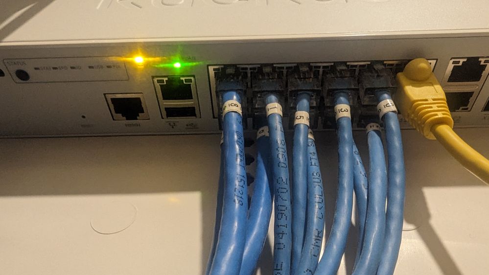

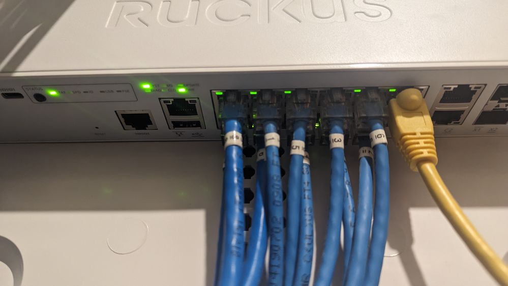

As of this morning, my switch is rebooting constantly. Every 15-30 minutes. I called Ruckus support and they directed me to this forum. Please assist me with troubleshooting.
I saw several other posts regarding this same issue, but do not see how/if this was resolved. I tried to follow the instructions provided by Imran on ‎this post at ‎07-21-2023 09:15 AM so that I could provide more information, but I ran into some issues. I could not connect via IP as the connection was timing out, this is definitely the IP for the switch as I confirmed it on the Comcast router's connection table.
I was eventually able to connect with a USB serial connection, but could not run the commands that Imran suggested to the other user as the Putty session is constantly being flooded with information on what the switch is doing. I have a complete export of the Putty session log that shows what the switch was doing from the time I connected, it rebooted, came back online, and then rebooted again. I do not see a way to upload an attachment, only pictures. If there is a way I can provide this log, please let me know.
SSH Connection FailureSSH Connection Failure
After reboot is completeAfter reboot is completeDuring RebootDuring Reboot
