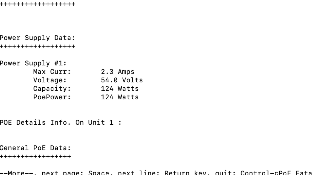

My ICX 7150 is stuck and cannot provide Poe
When trying to do a factory reset, nothing happens.
When connecting to console (through MacBook), the switch says:
Vmain (48V) fault has forced all ports on slot 0 to lose power.
i then try to go in boot mode to do a software recovery. I setup the Mac in TFTP. It is listening and permissions have been updated.
the console returns the following.
bcm_xgs_gmac-0 Waiting for PHY auto negotiation to complete......... TIMEOUT !
another option I can try is to wipe the switch and boot from usb. Would this be my recommended next step? If so, how?

Based on the troubleshooting done, and you confirm after the reset and booting up the Switch, the failure still persists with an error “PoE Fatal: Vmain (48V) fault has forced all ports on slot 0 to lose power.” this unit Should be RMA (Return Merchandise Authorization) in simple words replacing it.

02-01-2023 03:36 PM - edited 02-02-2023 04:44 AM
Hi @Vásquez_Fer
after a hard reset, it booted, but the failure persists:
PoE Info: Programming Ruckus defaults.....
PoE Info: Programming Ruckus defaults. Step 1: Writing port defaults on module in slot 1....
PoE Info: Programming Ruckus Defaults: Step 2: Writing PM defaults on module in slot 1.
PoE Info: Programming Ruckus defaults. Step 3: Writing user byte 0xf4 on module in slot 1.
PoE Info: Programming Ruckus defaults. Step 4: Saving settings on module in slot 1.
PoE Info: Programming Ruckus defaults....completed.
PoE Info: PoE module 1 of Unit 1 initialization is done.
U1-MSG: PoE Severe Error: PSU voltage is lower than min limit. Port 1/1/5 powered down. RMA the PSU.
