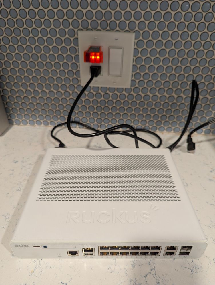

My ICX 7150 stopped working overnight - no power outage or spike - and now no longer powers on properly. When connecting to known good power source, the status lights flash amber once and then nothing. I cannot connect via serial either. I worked through the hard reset procedure many times (like 15x) and still no luck. Overall, this looks very similar to what other users reported, e.g.:

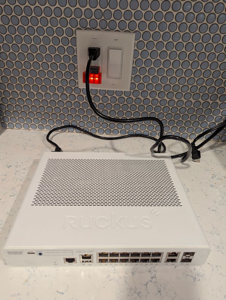

HI Imran,
Thanks for getting back to me on this issue. Here are the photos as requested. Video has been uploaded at the google drive you linked.

Thank you for sharing the requested PICTURES and a VIDEO.
Based on the troubleshooting done, your ICX-7150-C12P Switch is not powering up, and when plugged in, it flashes an amber light and then goes dark. And you confirm that the Switch is plugged into a well-known outlet/power source. However, the failure persists. This Switch unit Should be RMA (Return Merchandise Authorization) in simple words replacing it.
