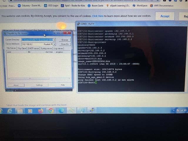

I was able to move forward after i installed the driver and connected both the cables but when i ran the commands it says the host is not alive. What could be missing?
Hi @JitendraMehta
Seems there is no connectivity between the computer and the Switch, please share the next.
From Switch run, the command
printenv
From the computer share the status IP address configuration
Yarenis Hernández.
Attaching all necessary screenshots.
Hi @ JitendraMehta
Thank you for the details provided, based on the troubleshooting you have done since the management port is not responding, the software recovery cannot be performed, this unit will be RMA (return merchandise authorization ), which means to replace it.
