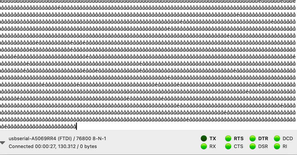

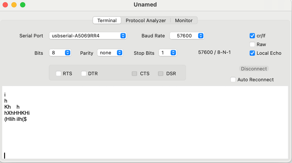

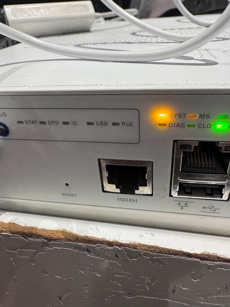

The problem with the swtich is that there is no traffic. There is just an amber light in the SYSTE led and green one on the one next to CLD. So i tried to connect the switch via serial cable. Tried with different baud rates but some strange letter and symbols start to appear (Images attached). I tried to reset the switch but same happens. Not sure why i can do to solve the problem, i was reading and it looks like there is a common issue with this switch doing the same.

From the Switch light status, it appears that the device is stuck in boot mode.
Please use a Windows laptop to perform the Software Recovery process, as it is the most reliable method.
Please refer to the detailed steps in the RUCKUS Lennar Knowledge Base article below:
https://community.ruckuswireless.com/t5/RUCKUS-Lennar-Support-Knowledge/Fixing-RUCKUS-Switch-with-an...
If you run into any difficulties or get stuck at any step, please feel free to let me know, I’m happy to guide you through the process.
