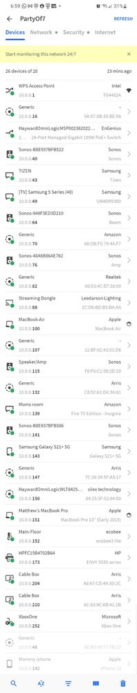

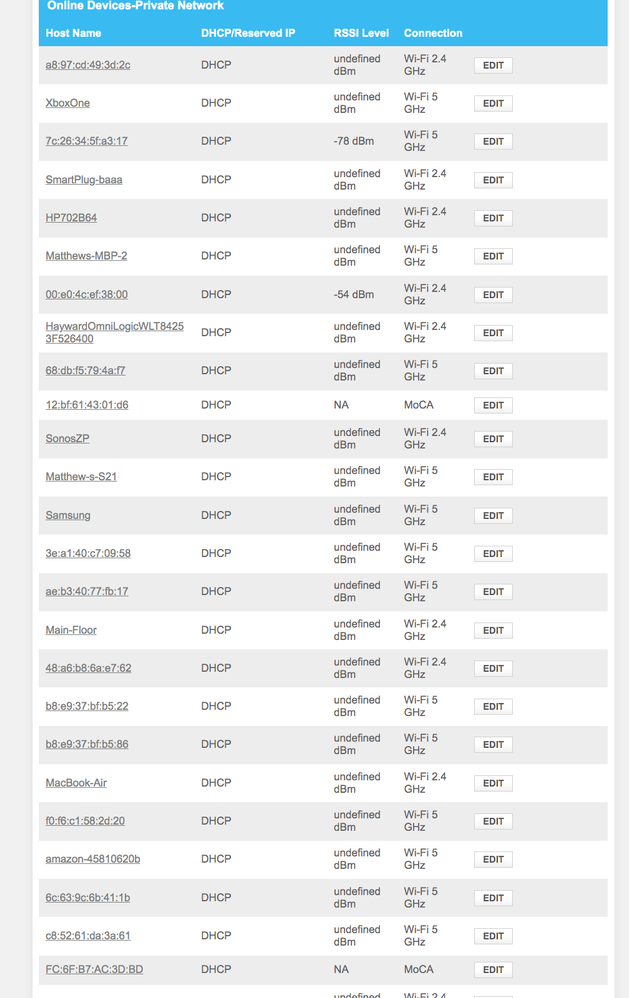

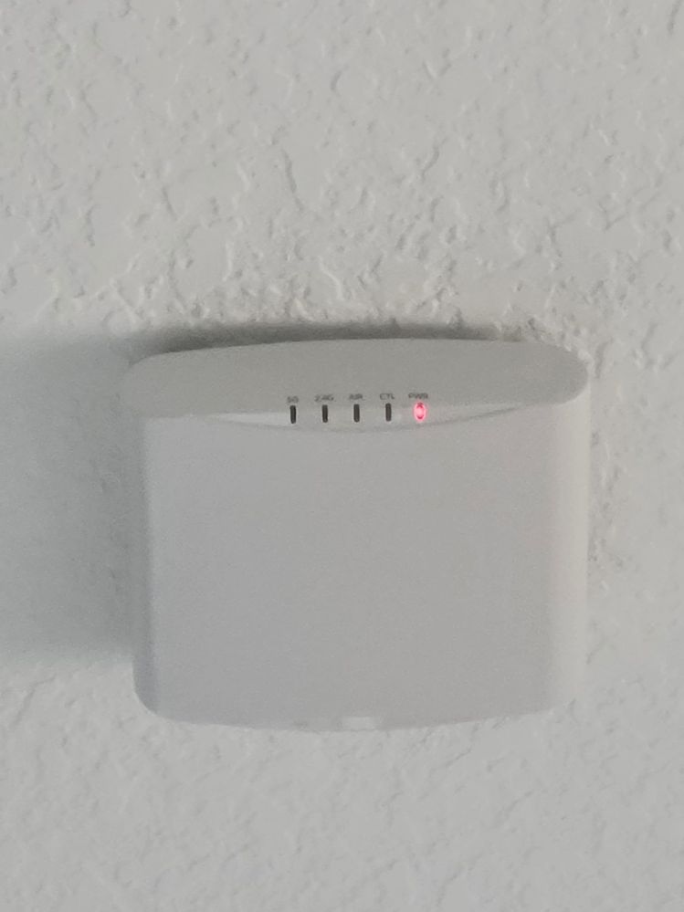

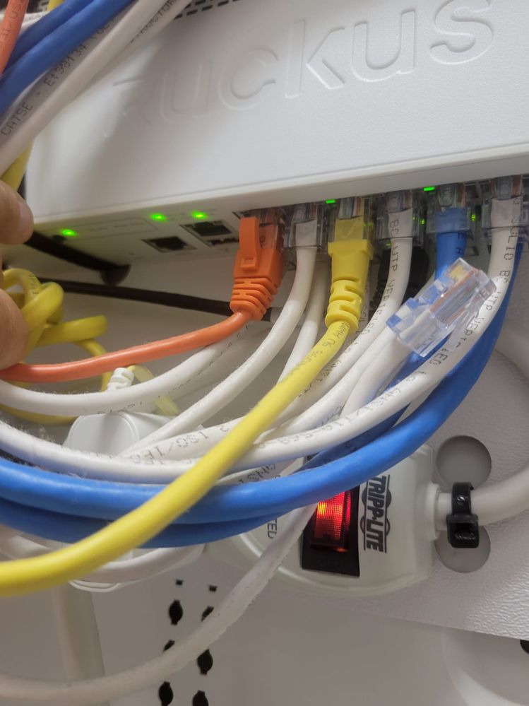

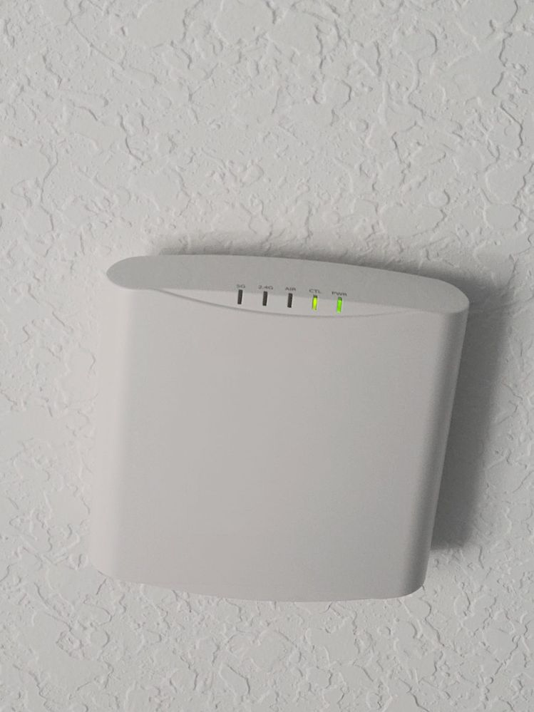

My ICX 7150-C12P and 2 access points no longer connected after power outage. We've had plenty of outages before and this has never happened. I read a few similar posts and tried to follow the instructions but Im stuck at the step of identifing the IP of my Rucus hardware. Its not showing up on the downloaded program, OR in the connected devices are of my router. The network from my regualar router works, but none of my devices like ring cameras, lutron lights, etc are able to connect because I believe they were connected to the extender network. Screen Shot 2023-04-19 at 6.58.34 PM.pngScreen Shot 2023-04-19 at 6.58.27 PM.pngWhatsApp Image 2023-04-19 at 6.59.22 PM.jpegWhatsApp Image 2023-04-19 at 6.26.16 PM.jpegUpstairs.jpegdownstairs.jpeg

Please confirm the Switch IP address with the name ‘Arris’ (As highlighted in the below screenshot) from the IP scanner results screenshot you shared. You should get the web interface as shown in the below screenshot.

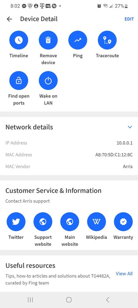

I got the IP or Arris, but I dont understand what the next step is. "Once you confirm the Switch IP address, please try to access the CLI as described below. And share the command outputs."

Please confirm the Switch IP address with the name ‘Arris’ (As marked in the below screenshot) from the IP scanner results screenshot you shared. When you browse the IP address in a web browser you should get the web interface as shown in the below screenshot.

The IPs are there in the image where you drew arrows and highlighted, why do you need me to confirm them? Threre are 5 listed, 10.0.0.1, 10.0.0.132, 10.0.0.147, 10.0.0.204, and 10.0.0.210. Those are cable boxes arent they?
