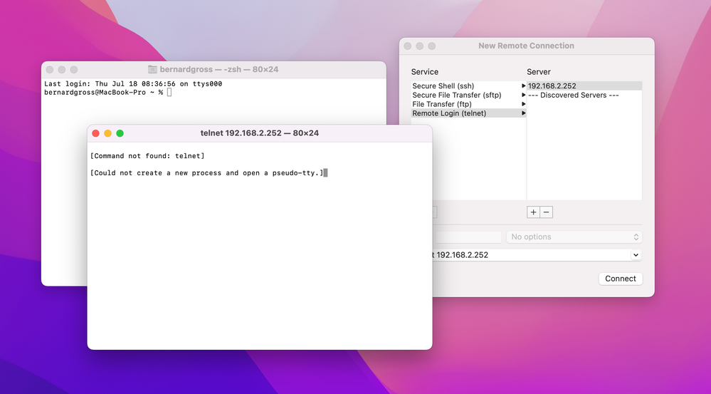

thank you for your quick and and detailed response, I was able to verify the ip address using the Ring mobile app but I'm using a MacBook and having trouble access PuTTY or using the Terminal app to allow me to telnet into the switch's ip so I'm stuck right after determining the IP address

07-18-2024 10:32 AM
Hi @bgross986
Please refer to the below process on how to access Telnet on MAC:
Telnet – Port 23
nc <IPAddress of the switch> 23
Example: nc 192.168.1.182 23
For more information on accessing CLI, please refer to the below RUCKUS Lennar Knowledge Base self-help article:
Please me know if you have any queries in this regard.

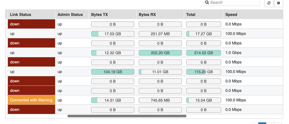

07-18-2024 11:45 AM
Thank you Imran,
