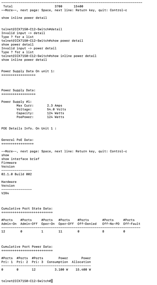

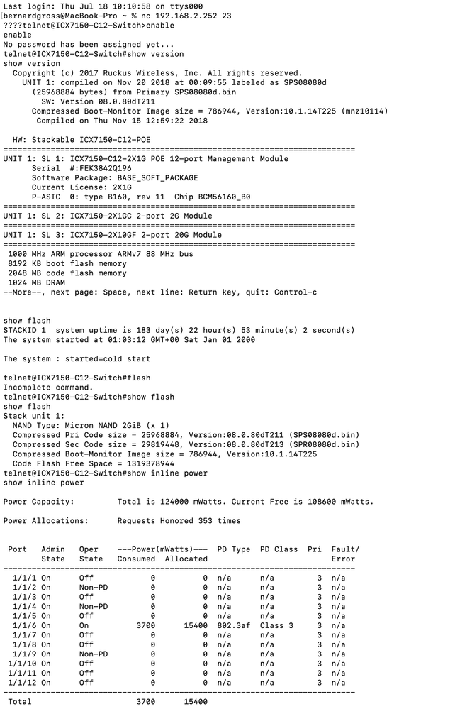

Hello Imran, here are the screenshotsScreen Shot 2024-07-18 at 12.01.33 PM.pngScreen Shot 2024-07-18 at 12.03.37 PM.png

As per the command outputs, switch seems in a normal state.
The both Switch partitions should run on the Switching code (SPS) to avoid these issues for Lennar home users. Second partition on your Switch is running on SPR code. Please perform the below commands to copy SPS on the secondary partition.
copy flash flash secondary  (hit enter to accept the command and wait: until the flash finished)
boot system flash secondary yes (hit enter to accept the command: the switch will reboot and takes some minutes to complete)
