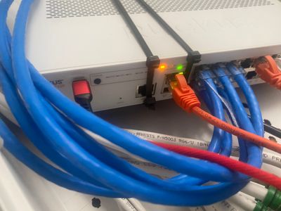

If it’s not working, could you please share the screenshots of the error and the configuration you did to perform a software recovery? Also, provide a picture of the cable connections between your Switch and the Laptop/PC that are connected to perform software recovery.

Apologies, as there is an amber/orange light on the "SYST" and a green light on the "PWR" on the Switch. Meaning the Switch is stuck in the boot mode, and it is a software issue. We cannot replace the Switch if it is not a hardware issue. Warranty is not covered on software issues as it can be fixed by the troubleshooting steps.
Please remove the other cables connected to the Switch except the 3 cables used for the software recovery process and a power cord. And perform it once again.
