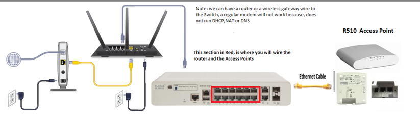

We suggest you check the Connection between Router, ICX-7150-C12P Switch, and Access Points as shown in the below picture:
Please refer to the below guide for connection setup as a reference:

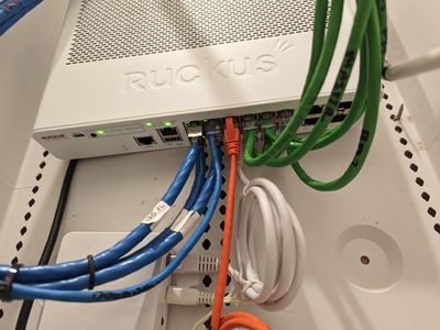

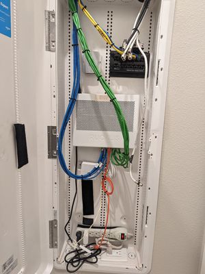

Hey, thanks for getting back to me!
Here's an overview of all the connections (see picture):
Blue cables go to AP1, AP2, AP3 and doorbell (AP - R150 Access Point)
Not sure what the green cables are, they are labelled "Master", "Master Ph", "BR", "BD2", "BD3", "BD4".
And a close-up of the connections (see picture):
The white cable is the Lutron smart lights and the orange was disconnected when we moved in (it may have been connected to the front security camera).

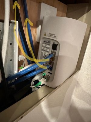

The router isn't connected right now since the lovely folks at AT&T needed to install the fiber optic line into the garage. I am not sure where the 2 blue cables highlighted in the picture below lead. I've raised a ticket with them to figure out how to get it connected into the Ruckus 7150 which two floors up!
