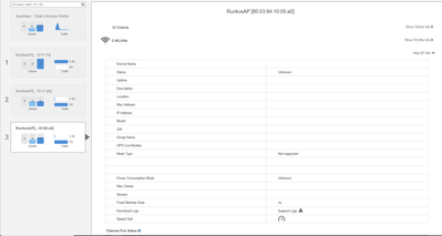

My R320 APs constantly gives only 250-300mbs speed whereas I checked the ethernet connnect to it gives 1000mbs.
I have three of these R320 installed and all would give lesser speed. My modem will also give speed of 950mbs.
I can't either login to Unleash app on my Iphone.
Please advise.

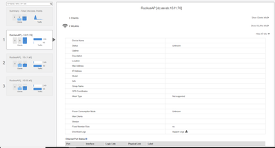

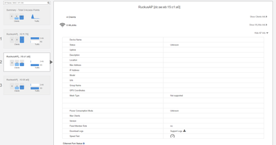

Please share the screenshot showing the Unleashed AP version. That is not the screenshot you shared earlier.
Please refer to my previous post carefully.

Hi @hareshoad
As there is no information on the APs from the screenshot you shared, and the status is unknown. At this point, we may have to proceed with the factory reset of the Access Points.
