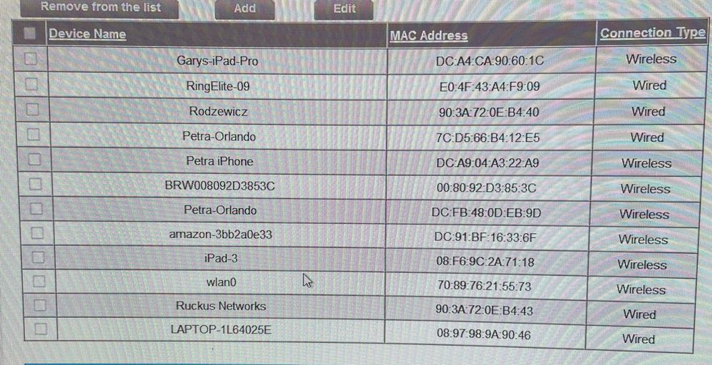

When I access my router, neither my Ring Doorbell nor the RUKUS show as active. However, they both show up with a MAC address as inactive (no IP address assigned).
