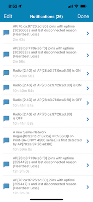

I recently changed my ISP to ATT and ever since I’m getting these Heartbeat loss alerts every 12 hours or so. I was asked to create my own thread to address my issue. Can you please help me get this resolved?

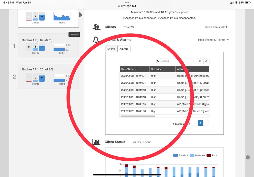

I suspect that something is wrong. How come alerts are showing under events& alarms in my unleashed web interface - attached, but not on my iPhone app? Plus, if I login with the social media option though Google it shows the alerts bell in the upper left corner - see attached. Please advise.
06-29-2023 11:17 AM
Hi @Rolo106
As I have already mentioned in the previous post, you will receive the notification and alerts as you have enabled mobile app remote management.

I just got another heartbeat loss alert after setting up another SSID. WHY DOES THIS KEEP HAPPENING? PLEASE BE CLEAR. OBVIOUSLY THIS IS AN ISSUE WITH YOUR PRODUCT SINCE THERE IS INFINITE USERS COMPLAINING ABOUT THE SAME THING. PLEASE CALL ME OR GIVE ME CLEAR INSTRUCTIONS.

It happened again! Can you please respond?
