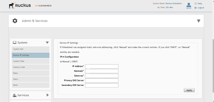

This issue may be due to changing of your IPS, as The IP address of the Master Unleashed AP changes at some particular interval of time and it obtains a new IP address from the DHCP server.
So, we suggest you configure a Static IP Address for the Master AP. (Please refer to the below picture)
