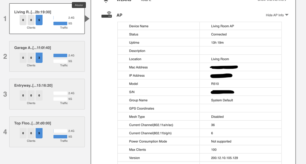

09-19-2023 10:50 AM
HI,
Please find the screenshot of the master AP with version. Looks like there is nothing populated for version. But I guess it should be the same as the master AP.Master AP details
09-19-2023 12:20 PM
Hi @shashv0711
Thank you for the response and for sharing the requested information.
As I see from the screenshot you shared, your Unleashed Access Points are on an old version 200.12.10.105.129 (please refer to the below screenshot). This is the reason you are unable to log into your Unleashed Application from your smartphone.
