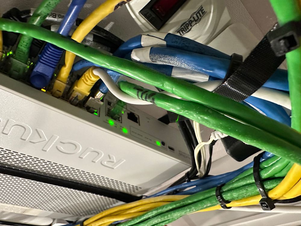

Some of my devices are not connecting to my Ruckus (ICX 7150-C12P). This seems to happen intermittently and randomly. Nothing has changed at home. Please help. Thank you!

Based on the picture you shared, it appears that the cable from your Internet Service Provider’s (ISP) router or Access Point is connected to the incorrect port on the RUCKUS ICX-7150-C12P Switch. The cable should be connected to one of the 1-12 ports on the switch (please refer to the screenshots below). Kindly unplug the cable and reconnect it to the appropriate port. Afterward, please reboot the ISP router by unplugging and plugging it back into the power outlet. Once done, check your internet connection.

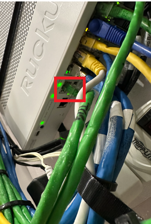

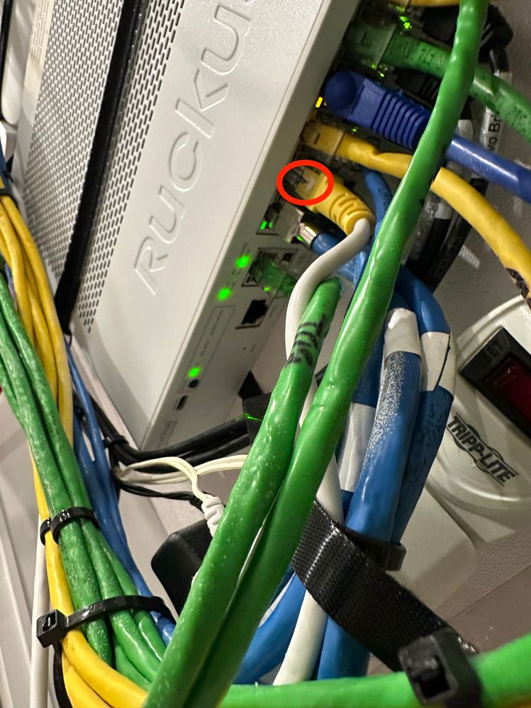

Hello, the cable from the ISP is connected to 1 of the 12 ports. I've placed a red circle around the cable in the pic. This problem spontaneously started in June without anything been changed since we purchased the house around 2020. I think I need to replace the Ruckus Switch or replace the whole thing with a new system. Is my Switch under warranty? Please help me resolve this since this ongoing issue has significantly affected work and life. Thank you very much.

As mentioned in my previous post, please unplug the green cable from the incorrect port and connect it to any one of the ports numbered 1 through 12. Your ISP or any other device should always be connected to one of these ports.
