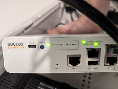

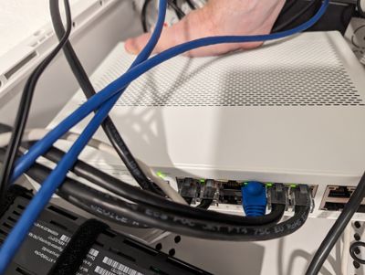

Hi @rohotomase
Please refer to the below picture and share a picture of the same, showing the light status and the FULL Switch panel cable connections to the Switch ports.

A little hard to get a clear shot but I think you can see all the connections in these 2 pictures.
