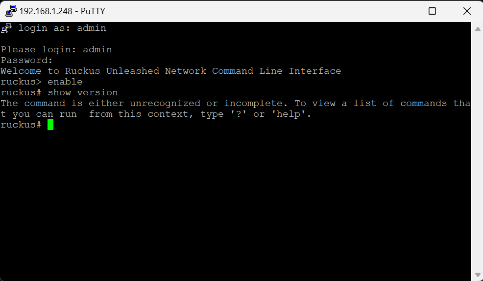

09-10-2023 08:25 PM
Hi Imran,
I have similar issues as Maggie did and tried to login ICX7150-C12 Switch with ssh, but I end up with at Ruckus Unleashed Network CLI every time. What did I do wrong?
09-11-2023 09:05 AM
Hi @simonsun524
Hope you are doing well!
As you are getting ruckus# Prompt, meaning, you are using a Unleashed AP IP Address and NOT the ICX Switch IP Address.
As this case is raised by @Maggie
To avoid confusion with posts, you can create your own post with the problem you're facing and a detailed description of the network issue and what you've done so that we can guide you properly.
