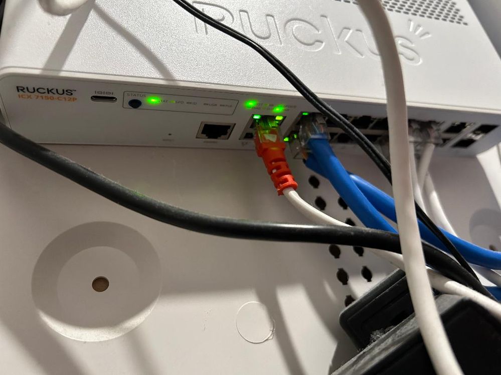

Here is the requested picture. I do not know which of the two blue cables connects to the affected AP though as they both are routed into the wall and are both identical. Is there another way to tell?

Could you please let me know to which port of the RUCKUS ICX-7150-C12P Switch the affected AP is connected? Please share the picture of the same, as shown in the below screenshot.

Hello @BillH ,
From the pictures you shared, it seems like the ethernet cable which is coming from the ISP’s (Internet Service Provider’s) Router or Modem/Router combo is plugged into the wrong port on the Switch panel. It must be plugged into any 1 in-12 ports as shown in the below screenshot.
Please unplug the ethernet cable and plug it into the correct port then reboot (unplug and plug from the power outlet) and try to connect to the Internet via Access Points.
It should be plugged into one of the 12 ports as shown in the below screenshot.
