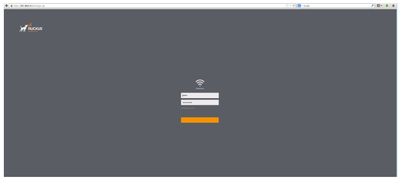

You should see the below Unleashed dashboard after finding the IP Address of the AP. Try to log in

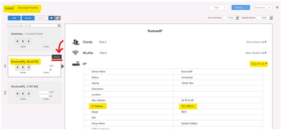

Refer to the below screenshot to know your MASTER IP Address on the Web Unleashed system.
Once you find and can log in via the IP Address of the Unleashed Master Access Point, please try the below steps.

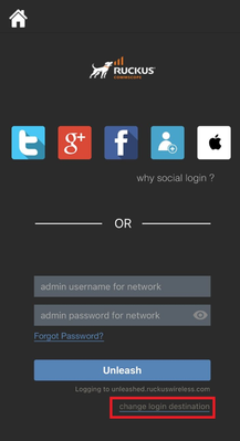

2. Click on ‘change login destination’. (Please refer to the below screenshot)

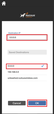

 3. Put your Unleashed MASTER Access Point IP Address as ‘Destination IP’ and save it. (Please refer to the below screenshot and 0.0.0.0 is just an example)
4. Now try to log in to Unleashed App using your credentials.
