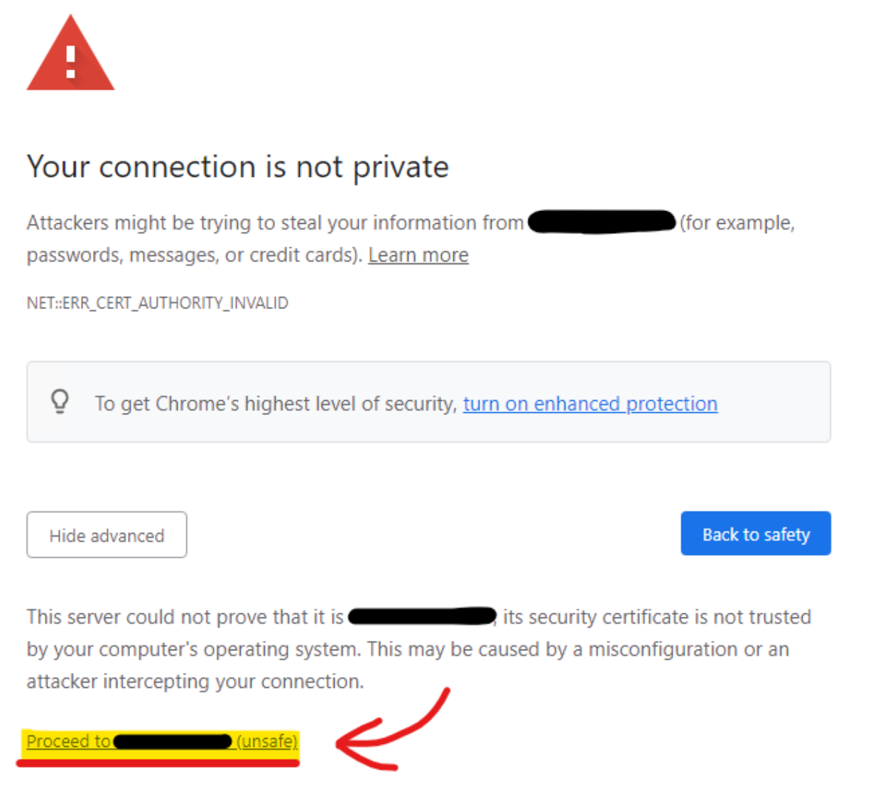

After a power outage I have been unable to get my RUCKUS R510 to function. I am unable to log into my app as it continuously tells me I am not connected to unleashed network, trying to log in on a desktop leads me to a website that doesn't seem to exist or tells me it is unsafe. I have attempted to upgrade the firmware and it sends me in circles.  The instruction guides posted lead me nowhere because I can't log in to anything. Please help.

Based on your description, it appears that you are experiencing difficulty logging into the RUCKUS Unleashed application and web browser.
This issue commonly arises when your RUCKUS Access Points are running an outdated version that prevents access to the Unleashed application.
Please note that the “connection not secure” dialogue is normal behavior. You could just click on proceed, as highlighted in the screenshot below.
A screenshot of a computer
1. Log in to the Unleashed system and upgrade your RUCKUS Unleashed system to the recommended version as described in the RUCKUS Lennar Knowledge Base self-help article.
https://community.ruckuswireless.com/t5/RUCKUS-Lennar-Support-Knowledge/Upgrade-process-of-the-RUCKU...
2. After upgrading all Access Points, uninstall the current Unleashed application and install the updated version.
3. Attempt to log in again and verify functionality.
