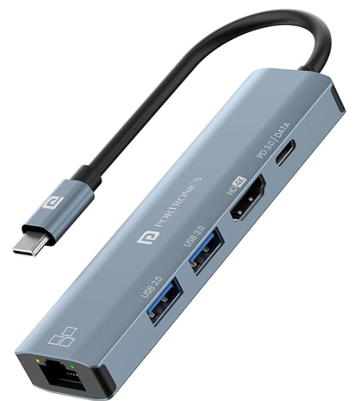

I have a macbook PRO that does not have an ethernet port (RJ45).  What are my other options?

For best results, we recommend using a Windows laptop to complete the factory reset process. If you are using a MacBook, you may need an external adapter to proceed. (Refer to screenshot below)

So basically I have purchase an adapter to complete this step?
