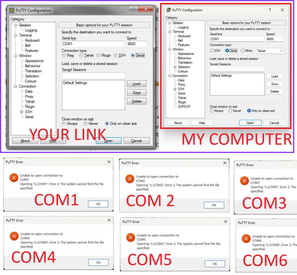

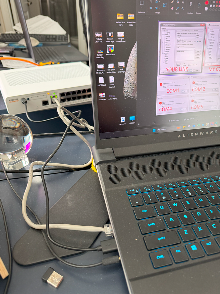

gablackburn
THE. DEVICE. CAN. NOT. BE. SEEN. BY. THE. COMPUTER.
Please explain how I can set the COM port in PuTTY if the computer doesn't know the 7150 is connected?  For your benefit I used the command prompt to PROVE the device is not recognized.
But, for your busy work to make me believe we're making progress, here are the results.  For safe measure, I tried to connect to 6 ports.  Shockingly all were unsuccessful.
And yes, the 7150 was connected to the computer while trying to connect in PuTTY.  Here is your proof to save us another email cycle.
it really is connectedit really is connected
