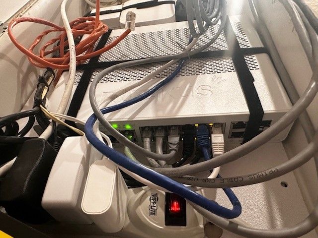

Yes, I do see the lights on the switch. Please see attached picture.

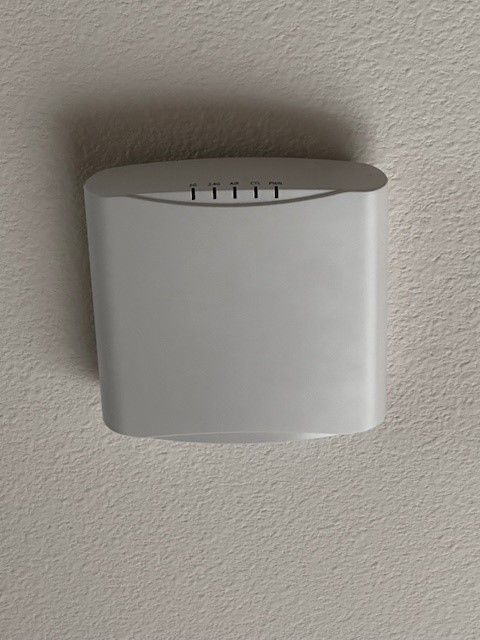

But there are no lights on for both 2 routers:
Thank you for your help.

Could you please unplug and plug the ethernet cable of the Access Point into any other 1 in-12 ports and check? Please refer to the below screenshot. Reboot (unplug and plug from the power outlet) the Switch once.
Also, I see an ethernet cable plugged into another port on the Switch, all the device cables must be plugged into 1 in 12 ports. Please refer to the below screenshot.

Hi Imran,
I have done all as you instructed but they aren't still working. What else should I try?
