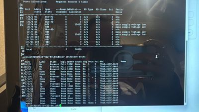

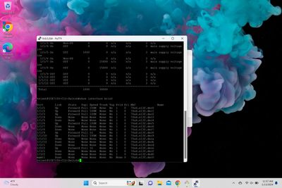

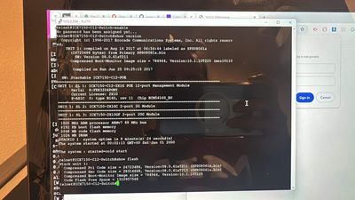

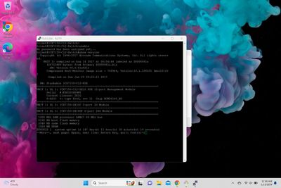

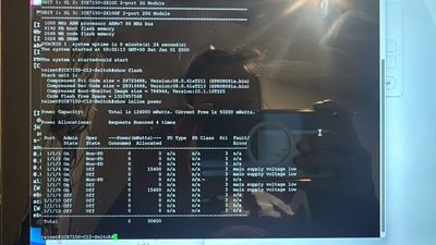

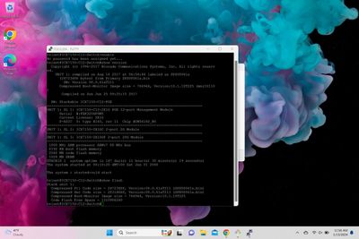

01-13-2024 12:02 PM
Here are the outputs:
01-13-2024 03:47 PM
After hard reset
