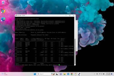

Could you please download the Putty Application and try to log in to the CLI using the Switch IP Address from the IP Scan and share the output of the below commands?
Putty download link:https://www.putty.org/
You could try the Telnet option to log in to CLI (Putty).
Telnet – Port 23 (If SSH doesn’t work)
ICX7150-C12 Router> OR
ICX7150-C12 Switch>
show version
show flash
show inline power
show interface brief
Please share the output of the above commands or share the screenshots if stuck at any step or error (if any) and let me know if you have any queries in this regard.
Here are the outputs:
Joyced
After hard reset
