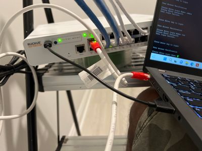

There will be 'ping not alive' error management port on the Switch is unable to contact TFTP server.
Could you please share a picture showing the software recovery cables connections between the RUCKUS ICX-7150-C12P Switch and the Laptop?

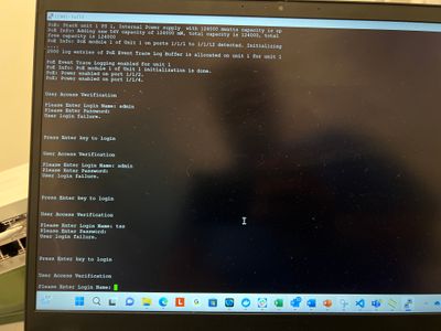

what are the login credentials here ?
08-11-2023 01:17 PM
Hi @Srinr
As I can see from the pictures you shared, your Switch is now with a normal light state.
Could you please let me know if you completed the software recovery process and now it is asking for login?
08-11-2023 01:18 PM
No it is asking login credentials which I don’t remember
