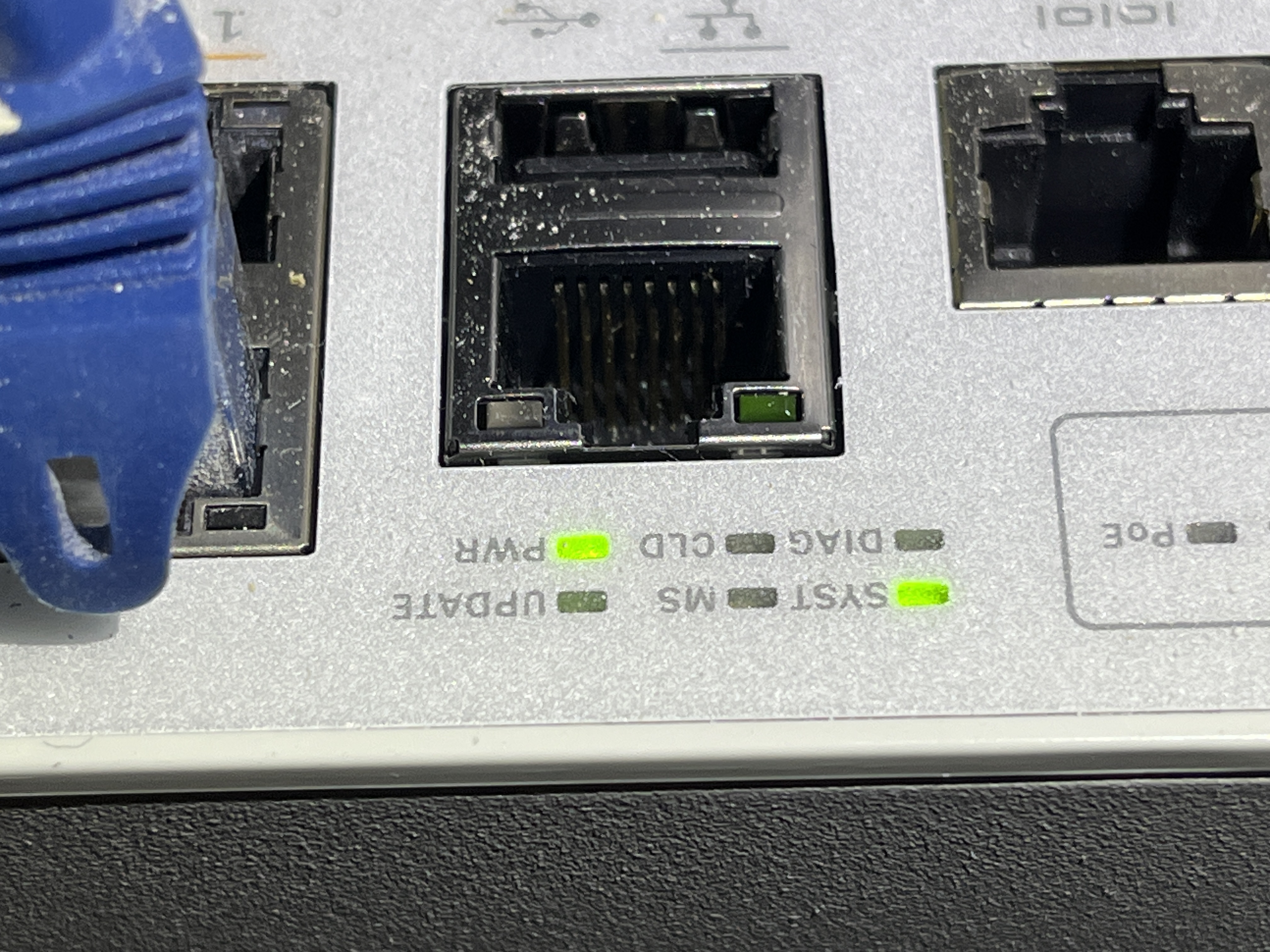

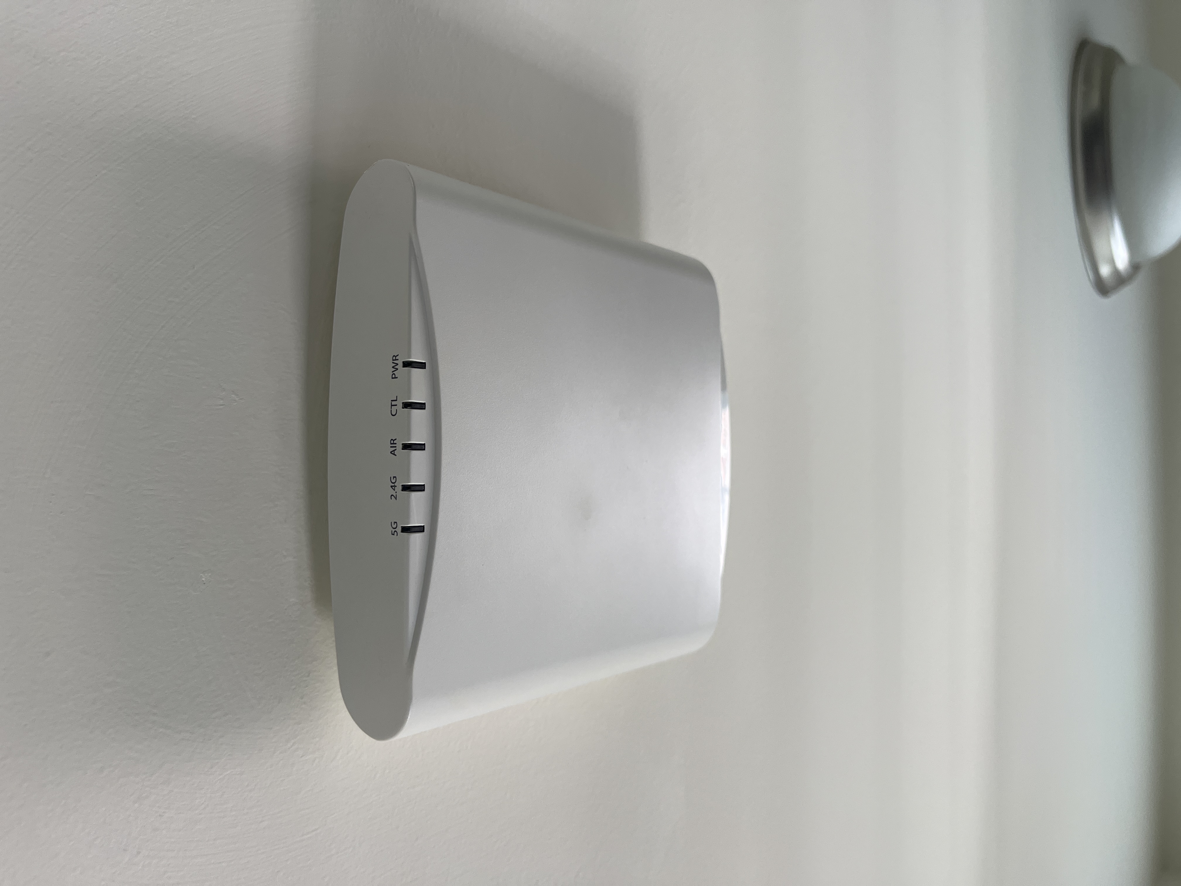

Access point is not connected to the switch, and all the light is on the AP is off.

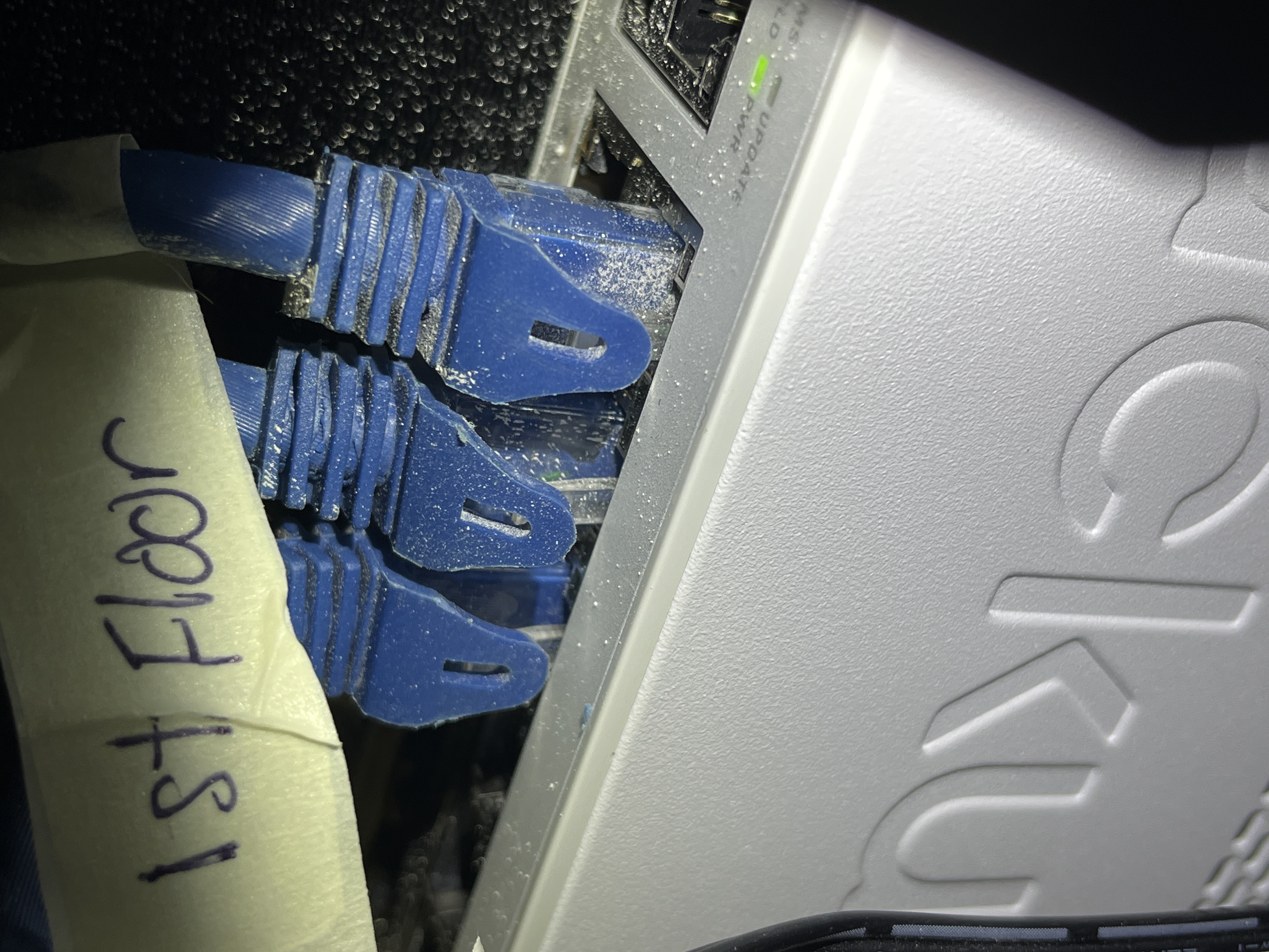

on the switch, two light next to the Ethernet cables from APa are also off for all of the APs
The status light on the switch is as follow.
I tried to unplug it and reset, it comes back for half a day and die again

Hi @Bredbred
Based on the information provided, it appears that you are encountering an issue with the RUCKUS Access Point with no power on it.
The RUCKUS ICX-7150-C12P switch is currently in a normal operational state based on its light status. However, it is possible that the switch ports have been disabled.
To troubleshoot this issue, please follow these steps:
1. Unplug the Ethernet cable from the Access Point (AP) that is connected to the switch port.
2. Reconnect the cable to any of the ports 1 through 12 on the switch (please refer to the screenshot below).
If the AP does not power on after performing these steps, we may need to manually enable the switch ports via the command line interface (CLI). For detailed instructions on how to do this, please refer to the following RUCKUS Lennar Knowledge Base article:
Should you encounter any difficulties during this process, please do not hesitate to reach out for further assistance.
