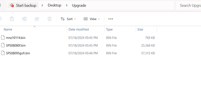

Please ensure that you have the following three upgrade files/patches in your folder shown in the below screenshot:
If you have confirmed the presence of these files, kindly ensure that you select the commands correctly and attempt to execute them again, starting from "copy tftp flash <ipaddress> spz10114.bin bootrom."

varunkrissj
I do not see this file "spz10114.bin" in your screenshot.
varunkrissj
I see upgrade folder,
I executed the copy tftp flash <ipaddress> mnz10114.bin bootrom

varunkrissj
Also in the document  it says to execute
copy tftp flash 10.176.220.51 SPS08095hufi.bin primary”  (upgrade the image)
I do not see this file "SPS08095hufi.bin" in the upgrade folder.
