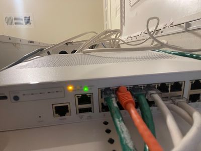

11-17-2023 03:31 PM
amber SYST light and green PWR lights are lit.
Switch Panel
11-17-2023 03:56 PM
Hi @Jsonh28
As you mentioned and from the pictures you shared I can see, there are lights on PWR and SYST, if there is an amber/orange light on the "SYST" and a green light on the "PWR" on the Switch (as it is in the below picture). Meaning the Switch is stuck in the boot mode.
Basically, due to the power outage/ power spike, the switch went to a state that we call ‘boot mode’ that is not able to boot up properly. And this is the reason your RUCKUS ICX-7150-C12P Switch is unable to transmit power (PoE- Power over Ethernet) to the Access Points or on its ports.
First, we will try to reset the Switch as described below VIDEO:
IF THE RESET IS NOT WORKING, PLEASE TRY TO RESET YOUR SWITCH MULTIPLE TIMES (Like 10-15 times) AS DESCRIBED ABOVE. As we have seen it working sometimes after trying multiple times in many cases. If the reset with a paperclip works, the SYST and PWR lights should turn GREEN.
Please note, we must use ethernet cable (both ends RJ45 plugs) and USB to type C cable both together as described in steps 2 & 3 in the guide link.
11-17-2023 04:42 PM
The reset seems to have worked SYST and PWR lights are both green and access points are now connected. Thank you for all your help! Have a nice weekend!
