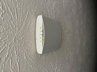

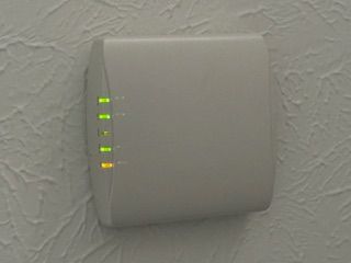

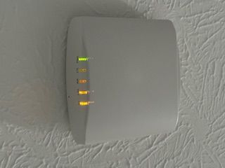

3. How many access points are currently connected to the switch? Please describe the status of the lights on the access points. Similarly, include a photo showing the access points' light status.

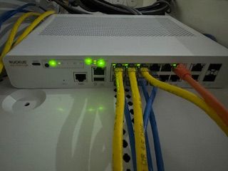

2.) All green lights on the switch
3.) 1st floor, green, orange, nothing, nothing, green.......2nd floor orange, green, nothing, green, green......3rd floor orange, orange, nothing, nothing, green

We may need to check some configuration. To proceed with troubleshooting the issue, please follow the steps outlined below to access the Command Line Interface (CLI) and provide the necessary command outputs:

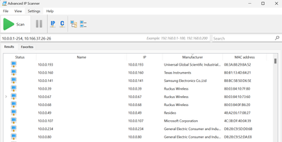

1. First, identify the current IP address assigned to the switch ICX-7150-C12P by your local router. You can use an IP scanner tool to easily locate the switch's IP address on your network. Here is a guide on how to perform this using IP Scanner free applications:
2. Once you have identified the IP address of the switch, proceed to access the Command Line Interface (CLI) of the RUCKUS ICX-7150-C12P switch. Here is a guide on how to access the CLI:
If you can access the Command line the prompt should look like below:
ICX7150-C12 Router> OR
ICX7150-C12 Switch>
3. After successfully accessing the CLI, please execute the following commands and provide the outputs:
show version
show flash
show inline power
show inline power detail
show interface brief
show ip address
Please share the command outputs or screenshots if you encounter any issues or errors during these steps.

It cant detect the IP address. It sees the access points, but not the switch. I can provide the mac address of the switch that is labeled on it.
