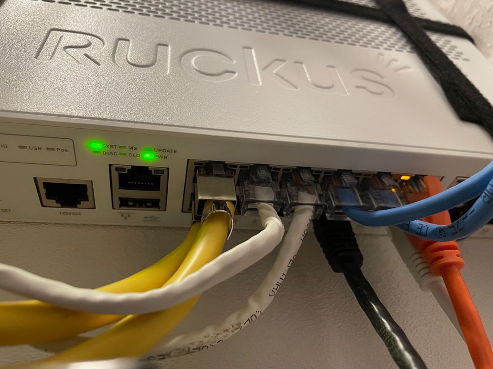

On your switch while it's plugged into the outlet, do you see any lights on? (Amber or green) Please let us know which lights are on. (Please refer to the below picture and share a picture of the same, showing the light status and the FULL Switch panel cable connections to the Switch ports)
Please let me know the answer to the above query and let me know if you have any queries in this regard.
04-06-2024 07:09 AM
Imran, thank you for the follow-up - apologies for the delay.
Please see the attached photo showing both green lights and an amber light on the switch. Please let me know what additional information I can provide.
