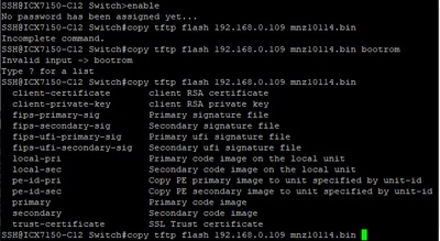

12-06-2023 07:59 AM
Jayavidhya,
I tried to use the tftp approach, however it looks like the last parameter 'bootrom' isn't valid. I replaced 'bootrom' with '?' to get the list of options, but not sure which to use.
Eric
12-06-2023 11:10 AM
Hi @elmoritz
Please upgrade the switch by using the following commands.
copy tftp flash 192.168.1.3 SPR08095gufi.bin primary
copy tftp flash 192.168.1.3 SPR08095gufi.bin secondary
Show flash (ensure that you have the new flash code)
Write memory
Reload
Once you are done with the above commands please try to reboot your router. After the update the switch will take a while to start up so wait for few minutes as you switch got upgraded.
12-09-2023 08:01 AM - edited 12-09-2023 08:05 AM
Jayavidhya,
Thanks for the response. One clarification with your response of "copy tftp flash 192.168.1.3 SPR08095gufi.bin ...", should the file be SPS08095gufi.bin and not "SPR08095gufi.bin" ?
I thought Lennar Ruckus switch needs SPS and not SPR images.
Eric
12-11-2023 06:12 AM
Hi @elmoritz
Thanks for your response,
Please upgrade the code 08095g UFI using the switching code in both partitions using the commands mentioned below.
copy tftp flash 192.168.1.3 SPS08095gufi.bin primary
copy tftp flash 192.168.1.3 SPS08095gufi.bin secondary
Write memory
Reload
