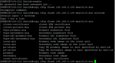

12-03-2023 09:06 AM
Jayavidhya,
I tried to use the tftp approach, however it looks like the last parameter 'bootrom' isn't valid. I replaced 'bootrom' with '?' to get the list of options, but not sure which to use.
Eric
