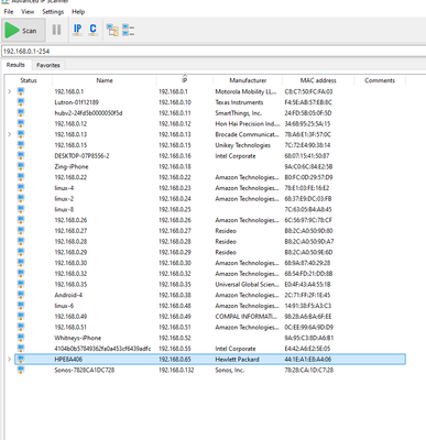

Here are the results of the scan in step one.
Hi @Zing
Seems like 192.168.0.13 is the IP address assigned to your ICX-7150-C12P Switch from your ISP Router. (Please refer to the below screenshot for the same)
Please use the same IP Address, follow the 2nd step guide link, and help us with the commands output results which are mentioned in the previous post.
Please share the output of the commands or share the screenshots if stuck at any step or error (if any) and let me know if you have any queries in this regard.
