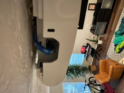

As I can see from the pictures you shared, the PoE is in the disabled state on the Switch. By which the Access Points are unable to get the power.
To enable the PoE on the Switch, please perform the below commands from the CLI:
Switch>enable
Switch#configure terminal
Switch(config-mif-1/1/1-1/1/12)#inline power
Also attaching a Screenshot as a reference:
Please confirm once it works or please let me know if you have any queries in this regard.
Thank you again.

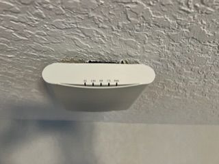

Hello, this is the only access point of the house. I understand the power source is the ethernet cable that goes into the media box, where everything seems on and working as usual. No light of the access point are on.
